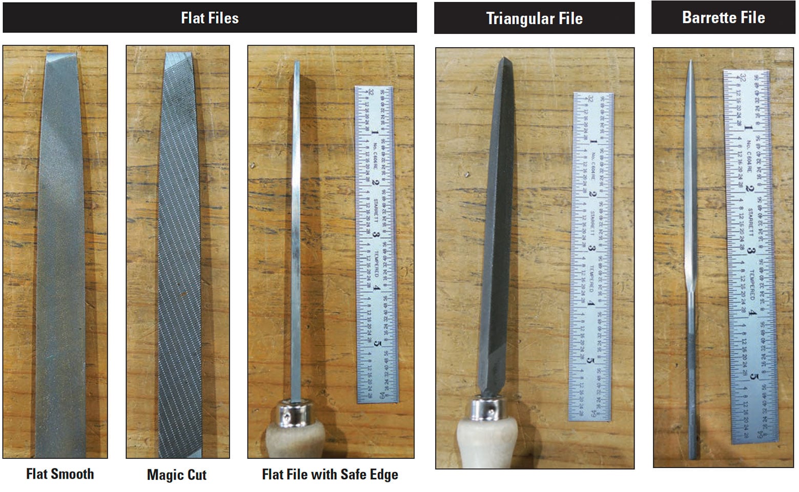

What are the Different Shapes of Metal Files?
Three flat metal files, including flat smooth, magic cut and flat file with a safe edge, as well as a triangular and barrette metal file.
Flat Files
Files come in many cross-sectional shapes, but the most basic is rectangular. A parallel-edged flat file is simply called a hand file and an American flat file is slightly tapered. Both American and hand files come in the largest variety of sizes.
Some have what is called a “safe edge”—that is, an edge with no teeth. This allows the file to cut into a corner with-out damaging the adjacent surface. It is good practice to polish the safe edge with a diamond stone or other type of stone to be certain the safe edge has no cutting capability. Grinding a safe edge is not recommended because it is likely to draw the temper, or heat-induced toughening, out of the file.
