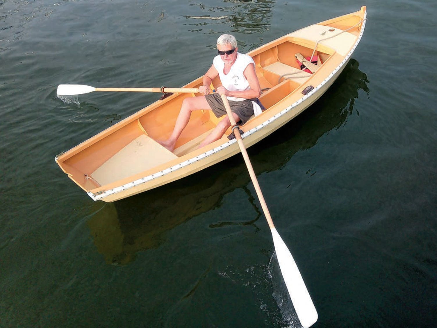

Man rows a Sea Bright skiff.Peter Murray
Reuel Parker designed and built a lightweight plywood-epoxy 13' Sea Bright Skiff that could be hoisted in davits yet would be a versatile tender for his 53' cruising sailboat, a capable rowing boat, and a good sailer.

I had designed, built, and sailed two Sea Bright models for myself: a 14-footer (see WoodenBoat No. 230), and my 50' cruising ketch T’IEN HOU. In 2020, I wanted a smaller boat—13' overall—as a seaworthy tender and lifeboat for my 53' deadrise cruising motorsailer, PEREGRINE. A boat of that length would be the largest I could practically carry in PEREGRINE’s side davits, and the size was not much smaller than some of the original Sea Bright Skiffs. I built the boat over two summers at my shop in Brooklin, Maine, after returning from my winter harbor in Florida.
