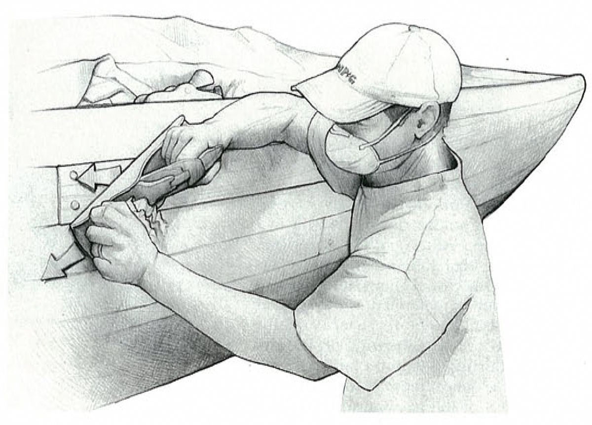

The first step in fairing new planking is to break out the planes. In the illustration, a new plank is being faired into the old, using the old as a guide.

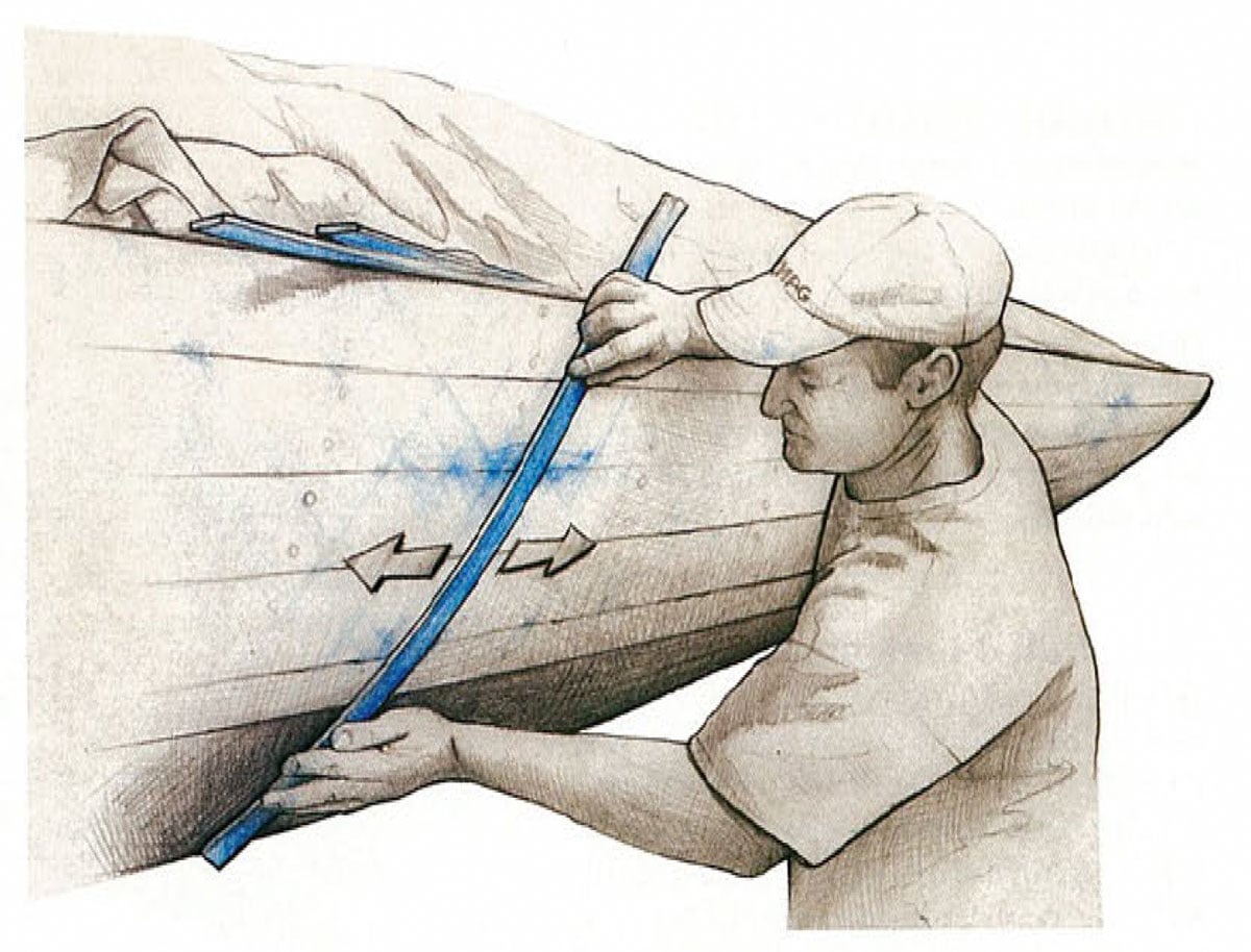

The ultimate goal of fairing is to reach a point where a boat-length batten placed against the hull will touch every­where, without showing any unfairness. In reality, the project's budget and schedule, and the worker's sanity, will limit the result to one that is pleasing to a critical eye.
We start the process conventionally with planes of vary­ing shape and length. Backing-out planes are used in the hollow areas of the garboards, broadstrakes, and the bow near the waterline. Bench planes and block planes are used on the rest of the hull.
