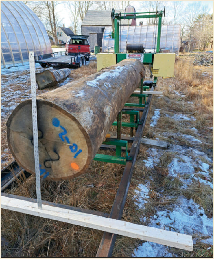

A tapered white-oak butt log, with measurements being taken from the bed of the sawmill to the top of the log to ensure that the log’s top surface is level.
