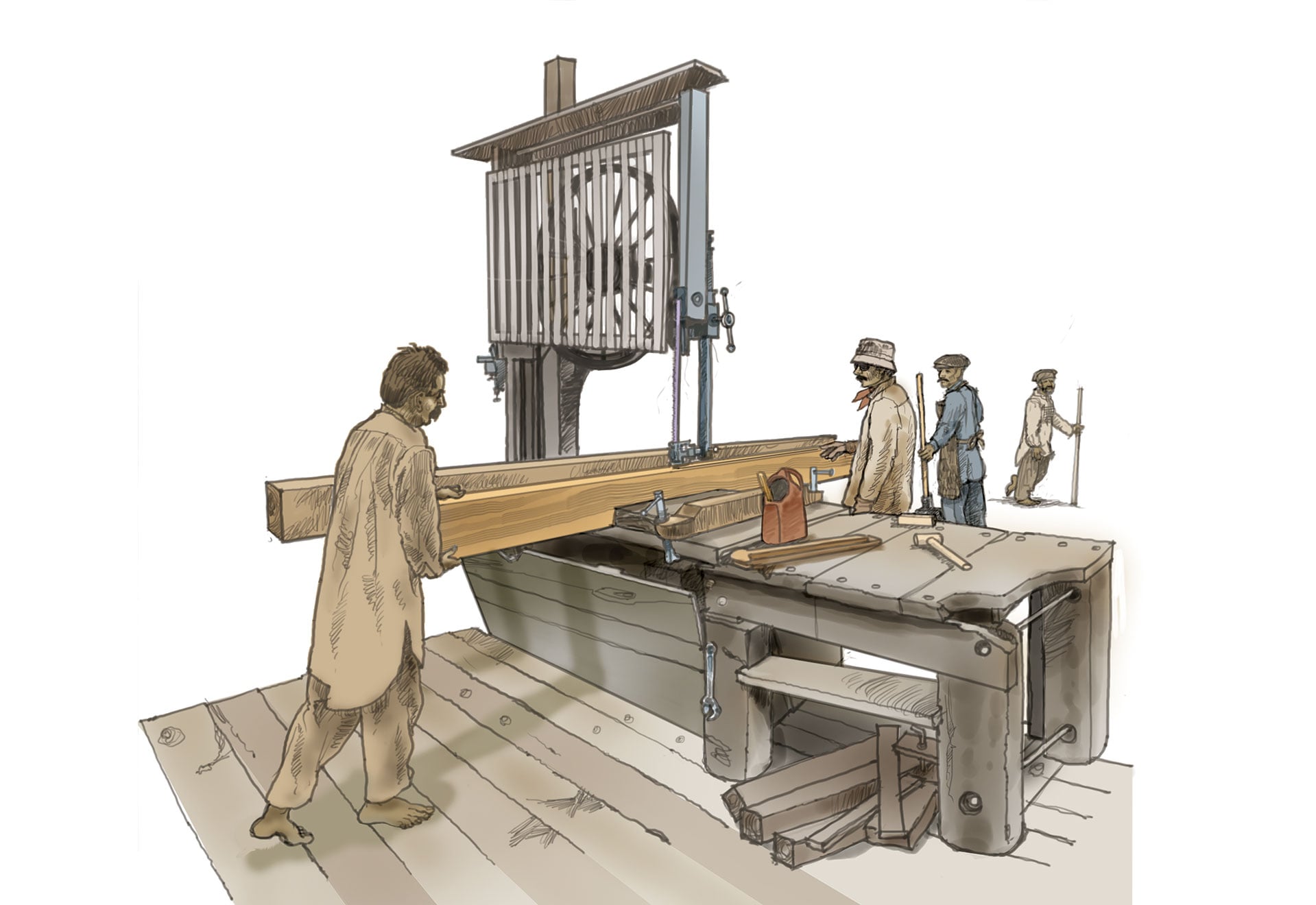

Workers using a bandsaw in India in an illustration.Jan Adkins
This large bandsaw is locally built and powered by a large electric motor; it serves a boatyard in India making traditional wooden dhows. It shapes interior structural elements and offers the bandsaw’s virtue of ripping consistent plank thicknesses with a minimal kerf, cutting with very little waste. The table is broad, the fence clamped to the table is stable, so wood fed through the blade by hand yields excellent results.
