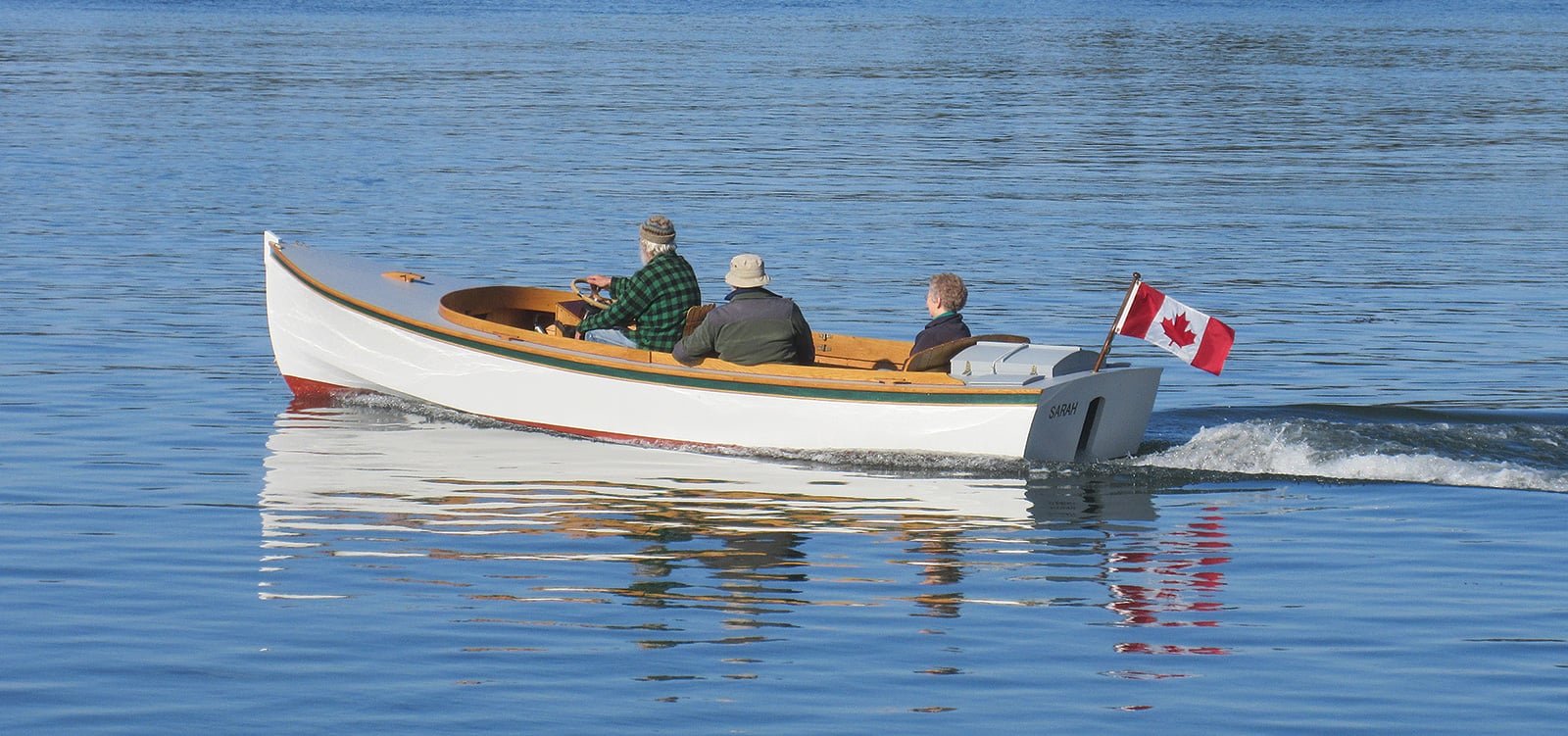

SARAH, a modification of the author’s Handy Billy design of 1997.Martha Bryan
SARAH, a modification of the author’s Handy Billy design of 1997 that he calls the Hand-e-Billy, is powered by a 3,000-watt electric outboard to her hull speed of just over 5 knots. Built to be trailerable, she has an 8,960-watt-hour lithium-iron-phosphate battery that charges on household power and can go 40 miles on a full charge.
