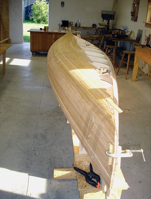

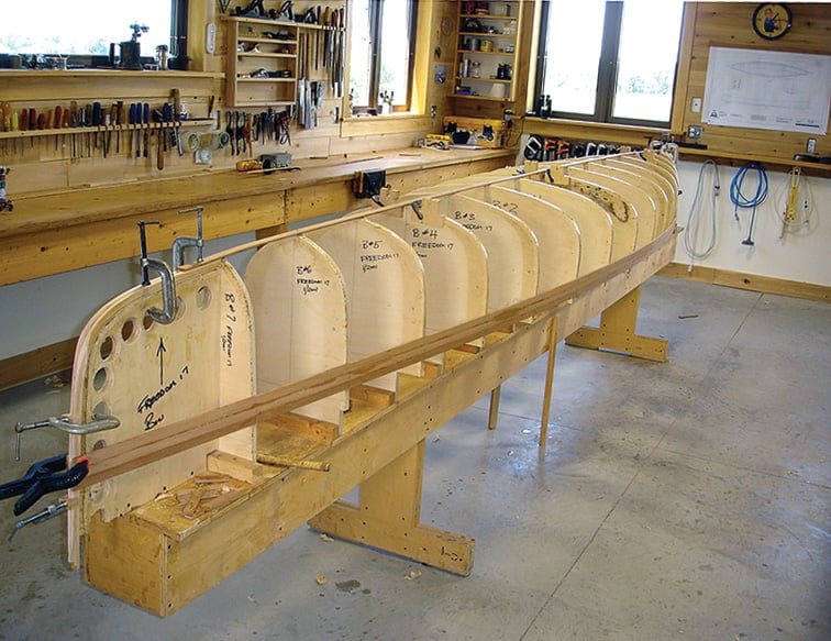

Strip-planking is simply joining the edges of narrow, uniform-width planks to form the shape of a boat hull. Many boat shapes—from canoes to kayaks to heavy cruisers—can be built with strip planks and fiberglass, as the accompanying photographs suggest.
In general, strip-planking requires fewer tools and skills than traditional building. The hulls have a high strength-to-weight ratio and, because the wood is sealed with epoxy, its moisture content does not change. The boats therefore remain light, and maintenance is minimal. Wood-strip-epoxy boats have a core of softwood planks sandwiched between layers of fiberglass cloth set in epoxy resin. One big advantage of this construction is the large number of full-sized plans and precut kits for strip-planked boats available to the home builder. This eliminates a number of complicated steps and the need for stationary power tools for the milling of strips.

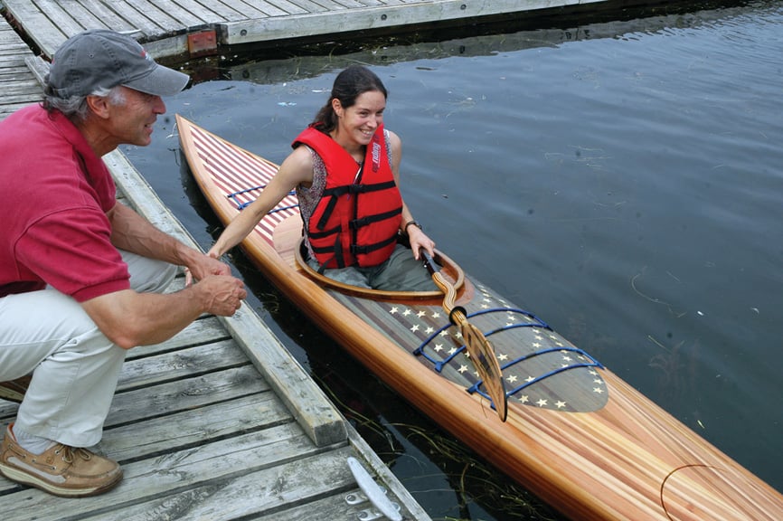

A kayak built to plans from Bear Mountain Boat Shop.

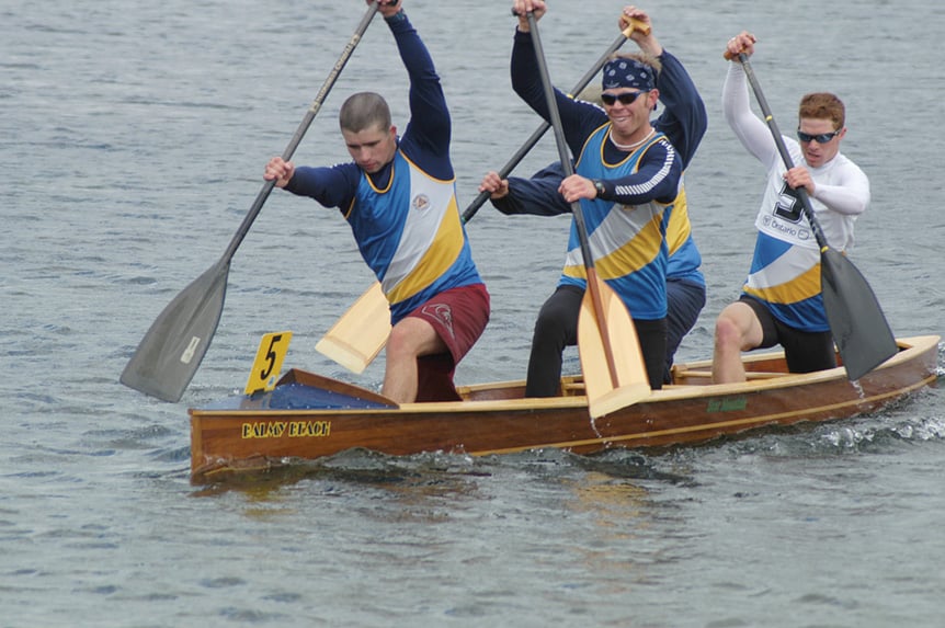

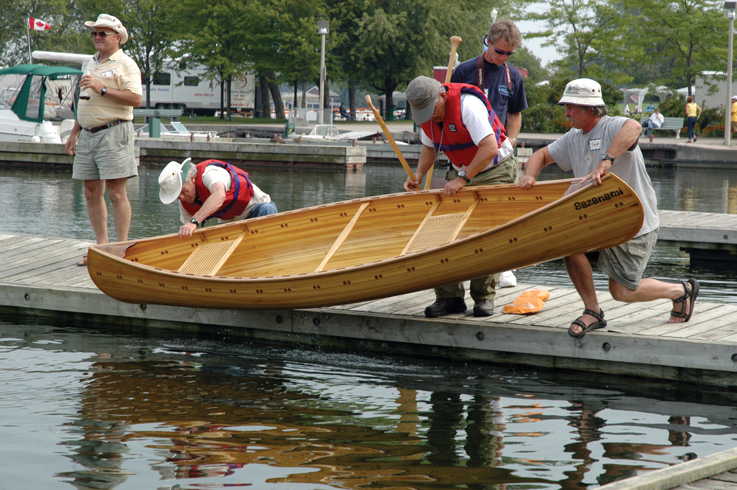

The edge of practicality and the edge of speed: A racing canoe, or “high kneeler".

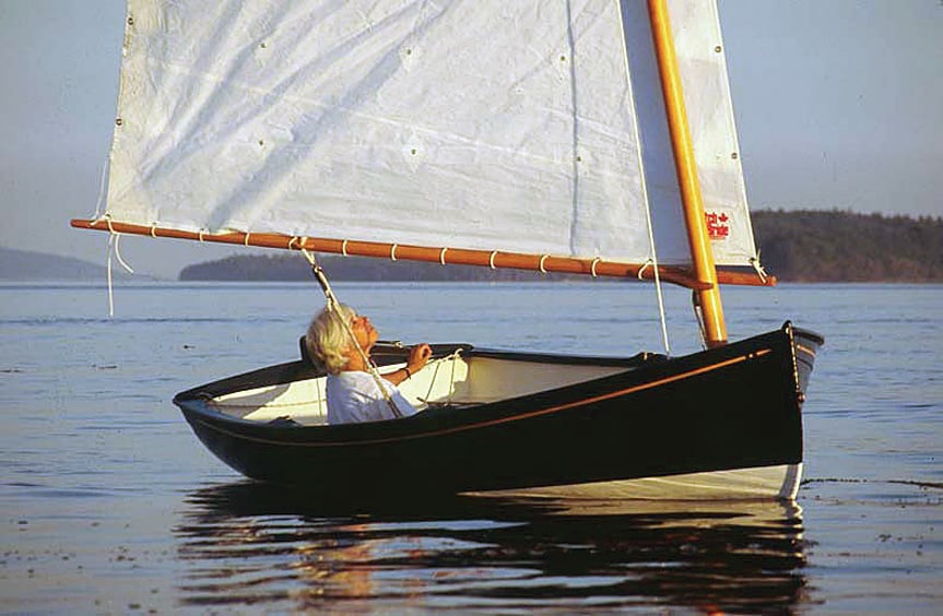

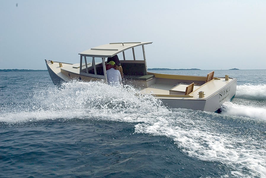

RIFF, a 12'3" daysailer designed by Paul Gartside.
