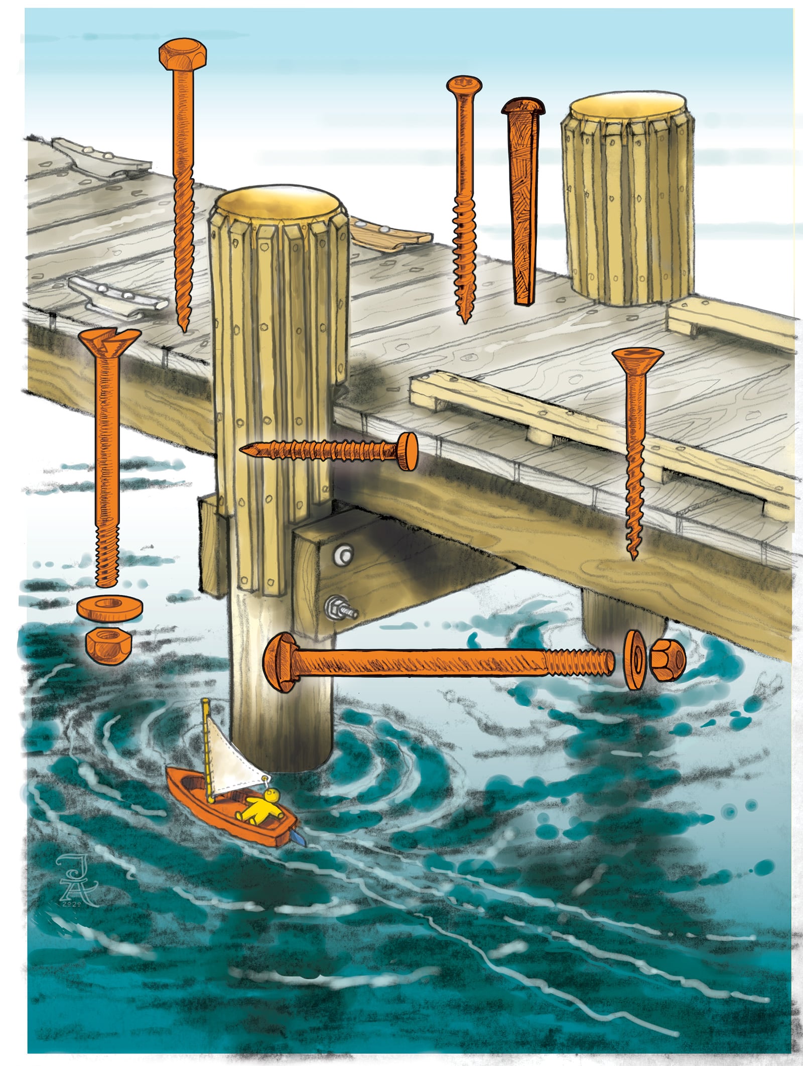

The drawing of a pier on our cover presents a gallery of fastenings. The crossbeams between paired pilings are fastened with robust carriage bolts, washers, and nuts of galvanized steel. They’ll begin to rust in a season or two, lasting marginally longer than ungalvanized steel. The long stringers between pilings are connected with the same nuts and bolts. The plank walkway is attached to the stringers with ring nails or cut nails. In contemporary construction, the planks would be fastened with long, coated “deck screws,” which are not unlike drywall screws. These are in no way stronger or more durable than the nails. The chafe-guard laths around the piling are fastened with ring nails. The dinghy tie rail is probably fastened with hefty stainless-steel screws to resist the tug of the little boats (since those deck screws are thin and brittle). The cleats are lag-screwed through the planks and into the stringers, or they’re bolted directly to the planks. However they’re fastened, care was taken to use the same material: galvanized to galvanized, or stainless to stainless, so that no electrolytic destruction caused by unlike metals was set up in the saltwater environment.
