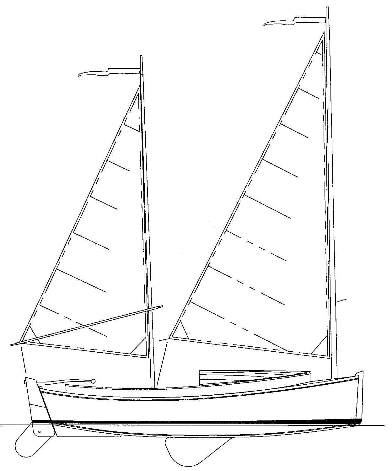

This Chesapeake camp-cruiser will carry us across the Bay and (with 6"-board-up draft) take us up the farthest creeks of the Eastern Shore. Catbird’s cat-ketch rig offers easy handling, and it looks fine. Her sprit booms, combined with jib-headed sails, will prove a revelation to the uninitiated. This arrangement goes by the unwieldy appellation “leg-o’-mutton” on the Bay.
Let’s take a look at its advantages. The foot of each sail (in tension), working with the sprit boom (in compression) and the mast, forms a triangular boom-vang that allows us to control sail shape and twist. To flatten the sail and lessen twist, take up on the snotter (the line that secures the boom to the mast) and/or slide it farther up the mast. Reverse the procedure to put plenty of shape into the sail for light-air work.
We can accomplish this magic with almost no store-bought hardware. At the mastheads, the halyards pass through well-faired drilled holes—“dumb sheaves” or “bee holes,” we used to call them. No blocks, expensive or otherwise, are required. Because the sheets need only pull the booms in, not down, they can be lighter and simpler.
