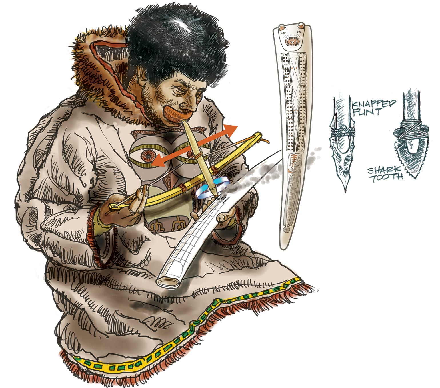

The Inuit craftsman is using a bow drill, a stick bent by the tension of a cord wrapped around a dowel.
Our Neolithic ancestors were just as intelligent as we are—perhaps even smarter because their work required more focused ingenuity. The Inuit craftsman in the illustration at right is using an ancient invention, the bow drill, a stick bent by the tension of a cord wrapped around a dowel. Put a hand piece (in this case, a mouthpiece) at the top of the dowel and lubricate it with a bit of wax or grease. Press down and pull the “bow” back and forth to twirl the dowel controllably. Our craftsman is making a walrus-tusk cribbage board, which requires precise drill placement and a consistent diameter to hold the game pegs, and this requires a drill bit, the business end of a drill—the cutting edge. Far from a hardware store in place and time, this craftsman may have used a knapped flint flake, or a small shark tooth bound to the spin-dowel.
