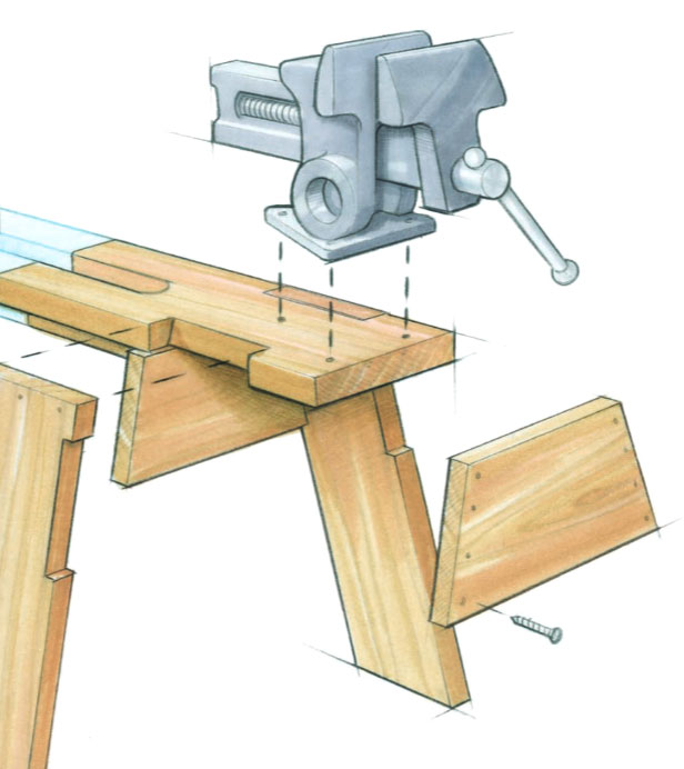

Some sawhorses are heavily built. One reason for this might be to safely take the weight of a heavy boat, set up on sawhorses for a season’s maintenance. Another might be to provide a very stable platform for ripping long stock. Harry Bryan describes one (shown above) that is solid enough to be fitted with a heavy vise when the job is outside the shop itself.
