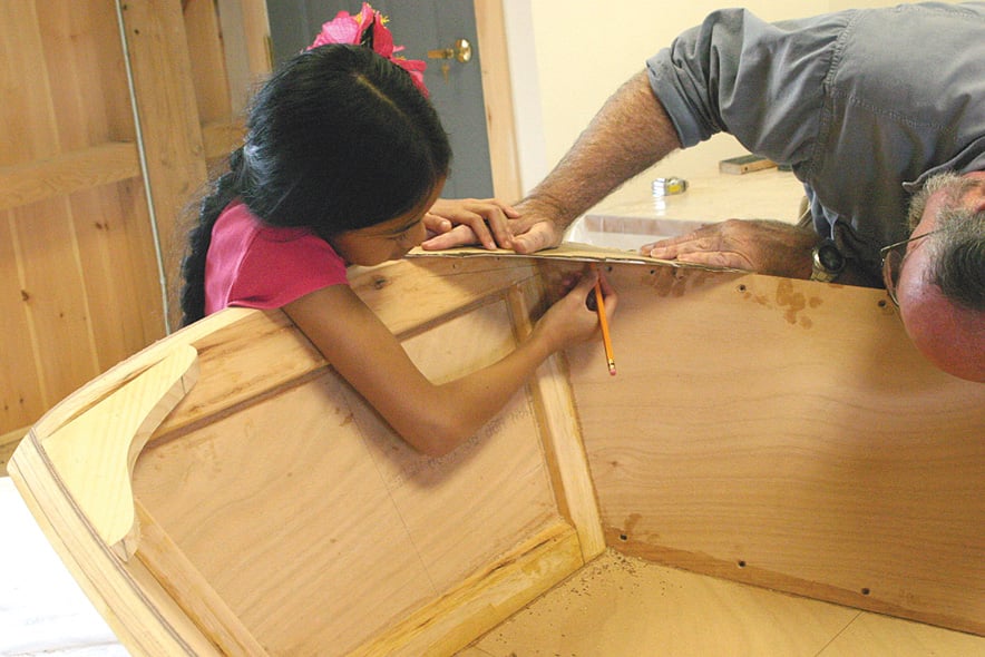

Lay a piece of stiff cardboard over the aft corner of the boat and mark the underside angle. That line depicts the top of the quarter knee and the angle of its two arms. Use the same technique to pick up breasthook information. Refer to the drawing to lay out the cutting angles and other features of the quarter knees and breasthook.
