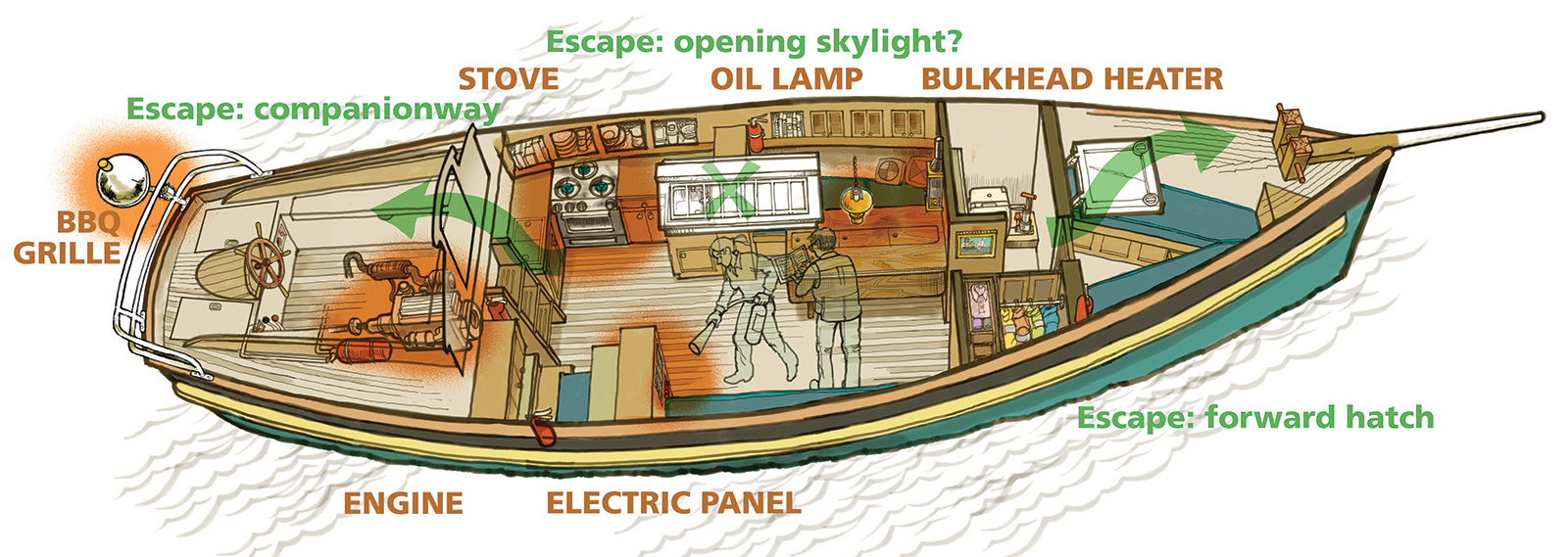

Drill day is a good time for the crew to review that stoves can cause both fuel fires and food fires, and that grease fires are never, ever to be put out with water. Say it out loud. Imagine the emergency. Where is the baking soda? How long does it take you to remove the closest fire extinguisher?
