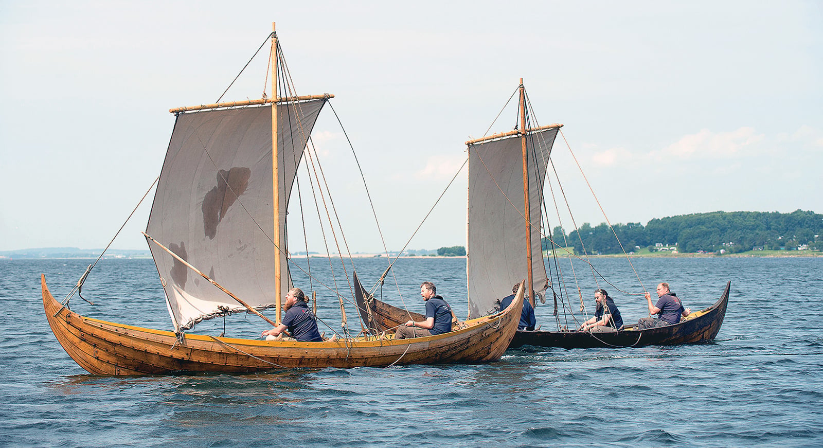

LANGÖE of 2017 (left) and GISLE of two years earlier (right).Courtesy of Viking Ship Museum, Roskilde
LANGÖE of 2017 (left), the Roskilde museum’s third reconstruction, reflects a reinterpretation of the original archaeological finds. She has one more strake than GISLE of two years earlier (right). Such constructions are a specialty of the museum’s boatshop.
