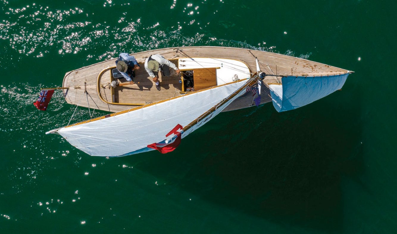

An oval coaming that transitions into the cabin sides, combined with sprung teak deck planking, lends an air of elegance to the Dark Harbor 17 1⁄2 KOTIMANA. She was built at the Northwest School of Wooden Boatbuilding in Port Hadlock, Washington.

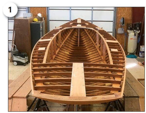

Before installing the plywood subdeck, we added blocking to support the port and starboard panels where they would butt together at the deck centerline, as visible in photo 1. We also installed blocking in way of the foredeck hatch, chainplates, mast partners, and deck-mounted hardware.
