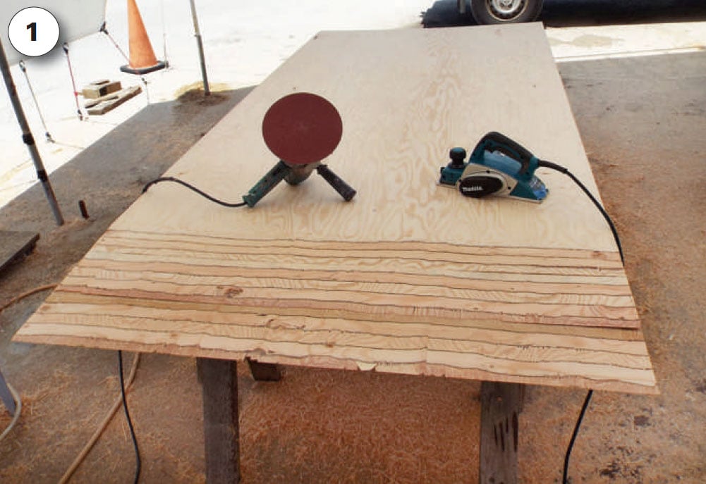

1. I chose Douglas-fir for my solid corners and Douglas-fir AB marine plywood for the front, back, sides, and also for the internal blocking. All the joints were glued with epoxy, backed up with pneumatically driven stainless-steel brads. My scarf ratio was 8:1, which resulted in a 4”-long joint for the 1⁄2”-thick plywood and 3” long for the 3⁄8” plywood. I used a power planer and a sander-polisher with 8" stick-on sanding disks to shape the scarfs.
