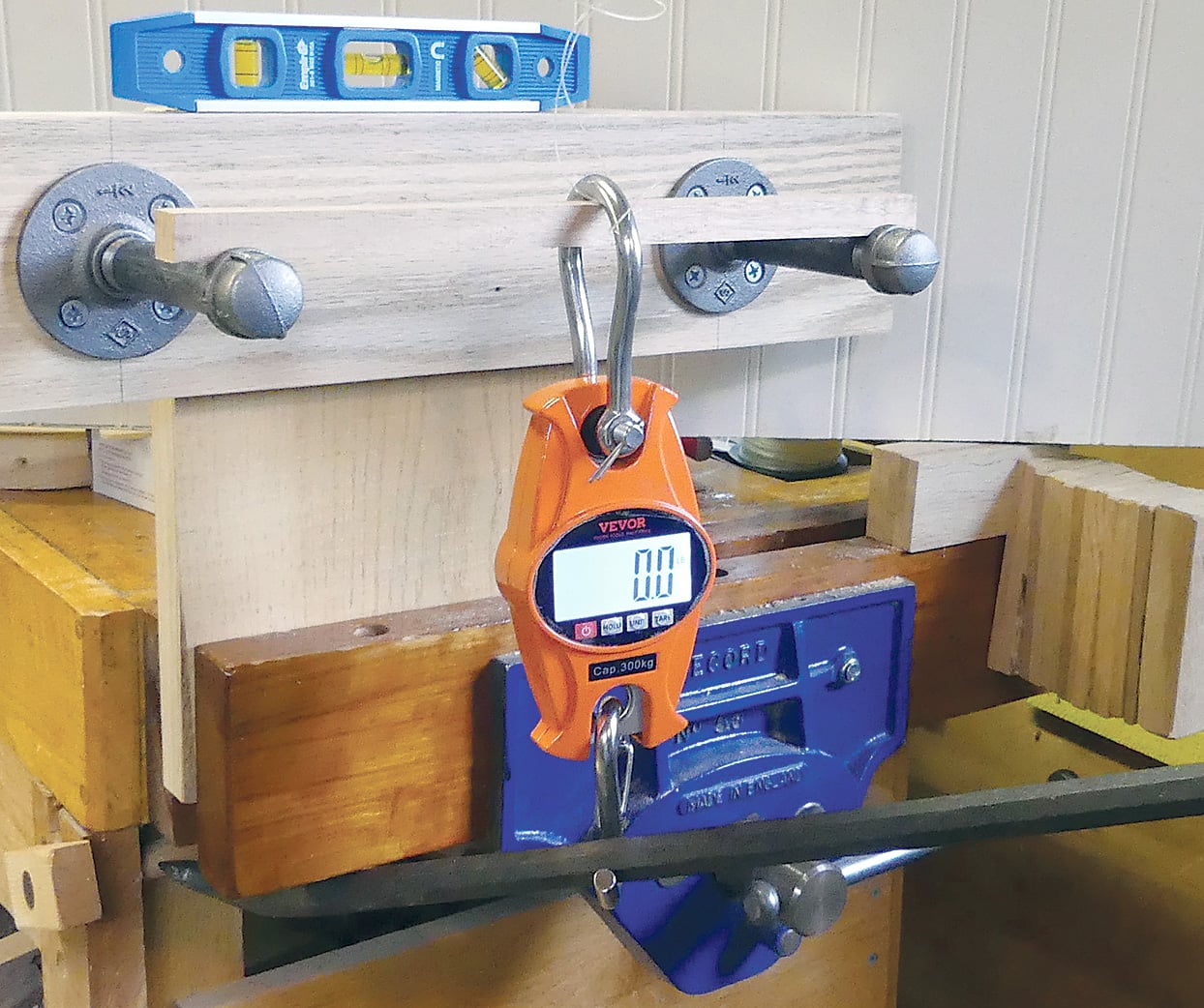

A simple device for measuring comparative wood-bending strength characteristicsDr. Richard Jagels
Photo 1—A simple device for measuring comparative wood-bending strength characteristics uses a pair of ½″ × 5″ black-iron pipe nipples capped and screwed into pipe flanges mounted 12″ apart on a ⁵⁄₄-thick oak plank. When this assembly is clamped into a bench vise and leveled, a hanging-crane scale with 300kg (660 lbs) capacity measures the bending force to the point of fracture.
