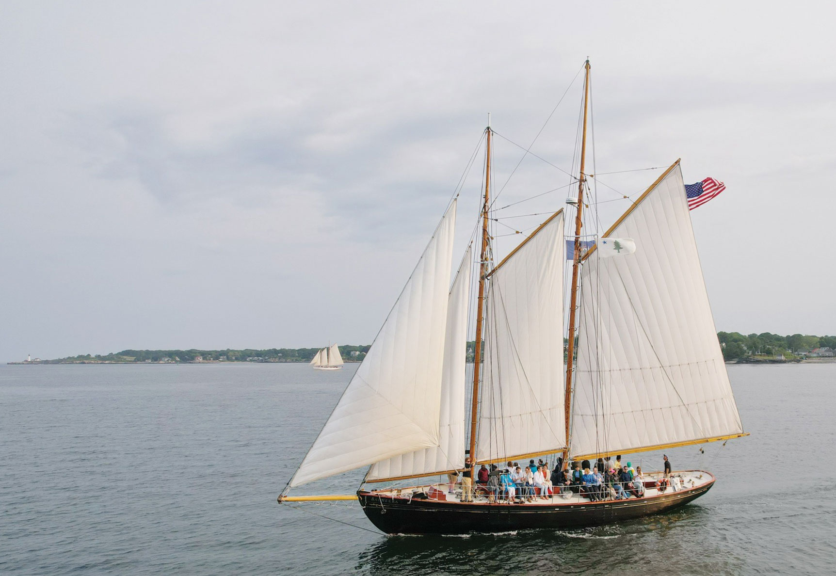

A group of people ride aboard the schooner BAGHEERA with a shoreline in the background.Courtesy of Portland Schooner Co.
The schooner BAGHEERA, launched as BEACON ROCK in 1924 by Rice Bros. Shipyard in East Boothbay, Maine, was saved from oblivion in the early 1980s by a rebuilding in Southern California. Today, she is the centerpiece of a charter business in Portland, Maine.
