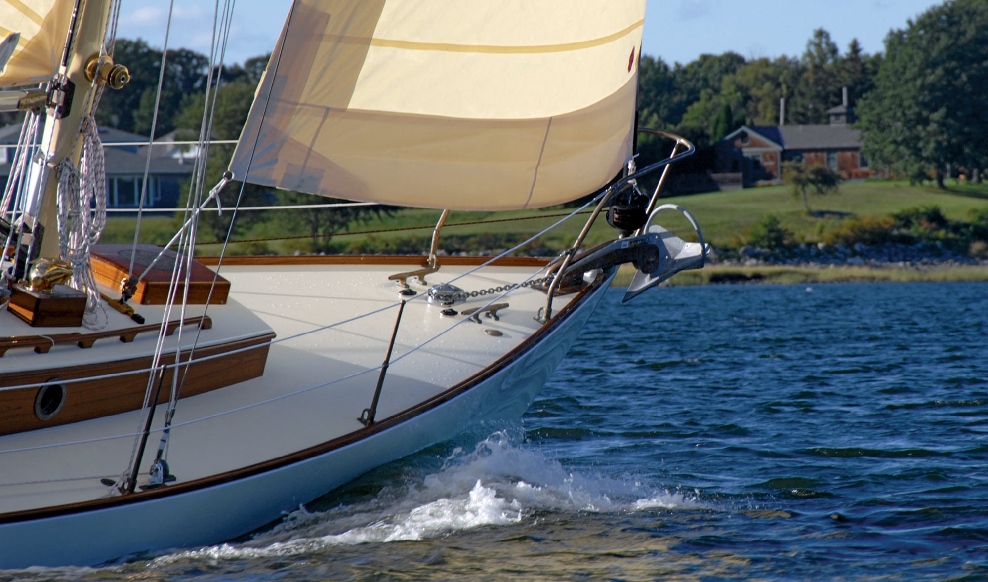

The crisp, clean look of a well-finished deck is as much about function as it is about aesthetics. Like the Alerion 26 described in this article, this Nathanael Greene Herreshoff–designed Newport 29, built by the author, has a plywood deck sheathed in fiberglass cloth set in epoxy, providing a durable, stable surface, with nonskid compound added for sure footing.
