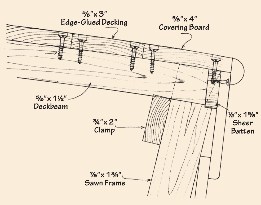

Figure 1—Deck framing at the gunwale for a lapstrake boat with edge-glued decking. Note the use of the sheer batten to receive plank, deck, and guardrail fastenings. The deckbeams fit into a slanted mortise cut into the sheer batten
