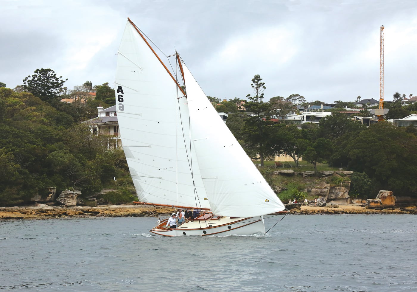

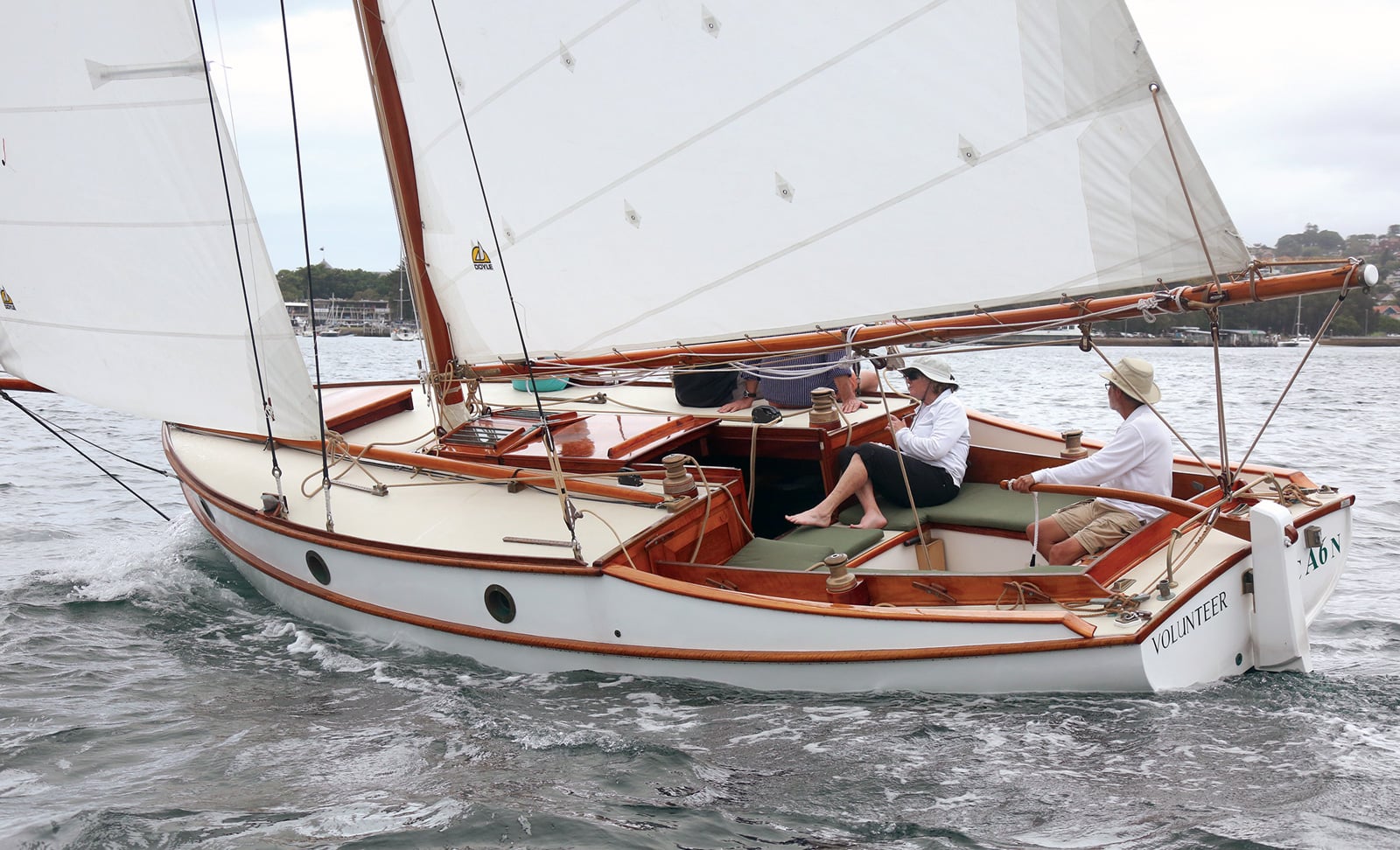

VOLUNTEER sailing in Australia’s Sydney Harbour.Nigel Sharp
VOLUNTEER is the latest member of the Ranger-class fleet on Australia’s Sydney Harbour. She is gaff rigged, as are her sisterships, but with a slightly different standing-rigging arrangement: most Rangers have swept-back spreaders with aft-leading upper shrouds and forward-leading lower shrouds. “That is just wrong for gaff rigs,” said her owner-builder, Ian Smith, who insists that lowers must lead aft to offset the forward force of the gaff jaws. “Aft uppers might give a tight forestay, but we have running backstays for that.”

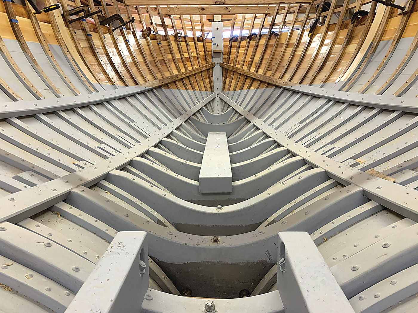

Ian Smith started planning a major project about 10 years before he retired as a professional boatbuilder in 2013. Although for many years he didn’t like the raised-deck styling of the Ranger class, he grew accustomed to their “unusual looks” and now thinks they are beautiful. In 2002, with the help of his then business partner Simon Sadubin, Ian took the lines off an original Ranger and built a suitable shed over his driveway. He began work on the boat, in earnest, in 2014 and launched the new boat, VOLUNTEER, in December 2024.
